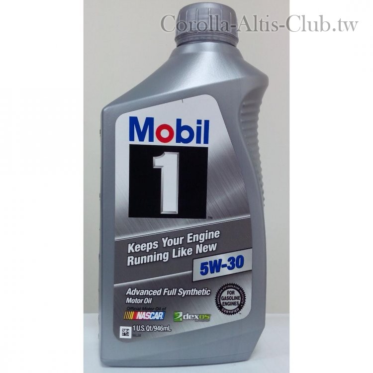

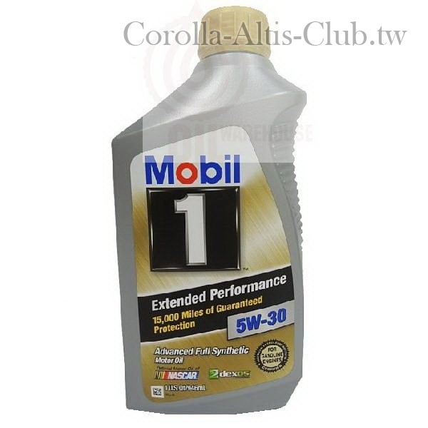

請問一下美孚5W30金蓋銀蓋有什麼差別

金瓶是長效號稱可以撐15000英里還公里忘記了,另外一瓶舊一般的

金蓋款在瓶身前方就有寫到為長效型可行駛15000 miles (約等於24000km),但是你去美國官網是有但書的,必須搭配長效型機油濾清器。

另外,保固內如果使用金瓶長效機油,千萬要以車廠手冊為主,也就是1萬公里要換油,不要15000 miles再換油,下面是艾克森美孚對這支機油的保固說明。
What the period of coverage is
The Mobil 1 Extended Performance limited warranty is valid for 15,000 miles or your vehicle’s OEM recommended oil change interval, whichever is longer.
Additional requirements for all Mobil 1 Extended Performance products include:
1.Oils must be put in service not later than five (5) years from the date of purchase; and
2.an oil change must be completed every twelve (12) months
